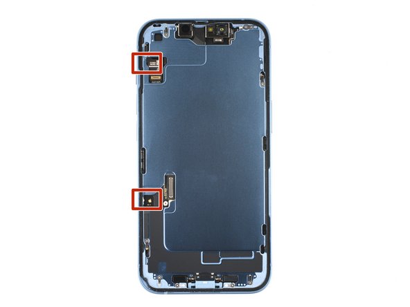

    11. iPhone 14 Plus Screen Replacement, Unfasten the display connector bracket screw: adım 13, 2 resimden 1. iPhone 14 Plus Screen Replacement, Unfasten the display connector bracket screw: adım 13, 2 resimden 2.
      Bu adımda kullanılan alet:
      Magnetic Project Mat
      $19.95
      • Use a Y000 screwdriver to remove the 0.8 mm-long screw securing the display connector bracket.
      • Throughout this repair, keep track of each screw and make sure it goes back exactly where it came from to avoid damaging your iPhone.
      • During reassembly, this is a good point to power on your iPhone and test all functions before you seal the screen in place. Be sure to power your iPhone back down completely before you continue working.
