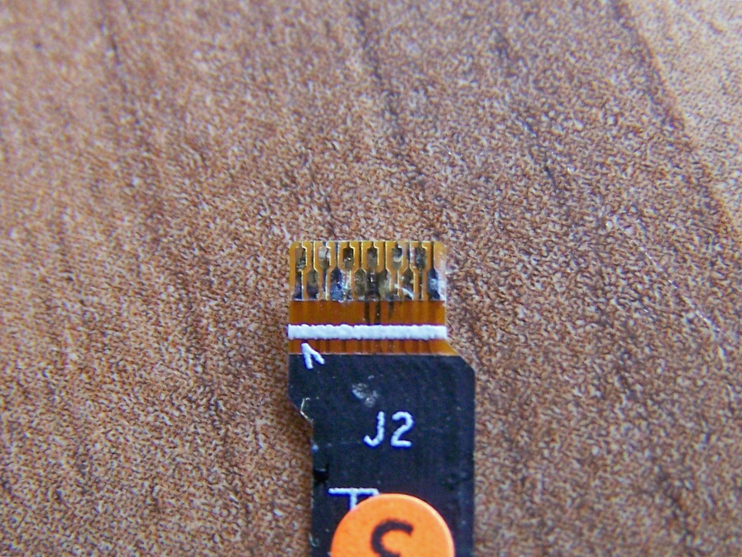

    • If your phone was fully submerged for any amount of time, it is likely some of the internal components corroded. Corrosion looks like a white, chalky film covering metallic surfaces, and is especially prevalent on pins and connectors that carry current. Corrosion dissolves metals and will cause malfunctions in your phone.
    • Inspect the logic board and any connectors for signs of corrosion, especially in areas where the LCIs are red.
    • Check any external ports (charging port, headphone jack, SIM card slot, etc.) for corrosion as well. These may have to be cleaned out with alcohol and a brush, or replaced if cleaning is not practical.
    • If all LCIs are white, and there is no moisture or corrosion, leave the phone disassembled in a warm, dry place for a day or two to make sure any potentially trapped liquid evaporates, then reassemble the phone.
    • If any LCIs are red, if there is corrosion or other liquid residue, if the phone fell into dirty/acidic/sticky liquid, or if you just want to be safe, continue for more thorough cleaning.

    • Use a soft brush (like a toothbrush or detailing brush) to gently scrub away any corrosion and liquid residue on the logic board and other components.
    • It's possible to break small solder joints with too much force from the brush. Use just enough force to remove the corrosion and residue.
    • Pay special attention to cable ends, battery contacts, connectors, pins, and fuses, as these parts are prone to corrosion and can easily cause the phone to malfunction.
    • Keep the logic board and any other alcohol-covered components over a cloth. There's a chance the alcohol can damage or mark your work surface.
    • If needed, repeat steps 8 and 9 until all corrosion and residue is gone.
