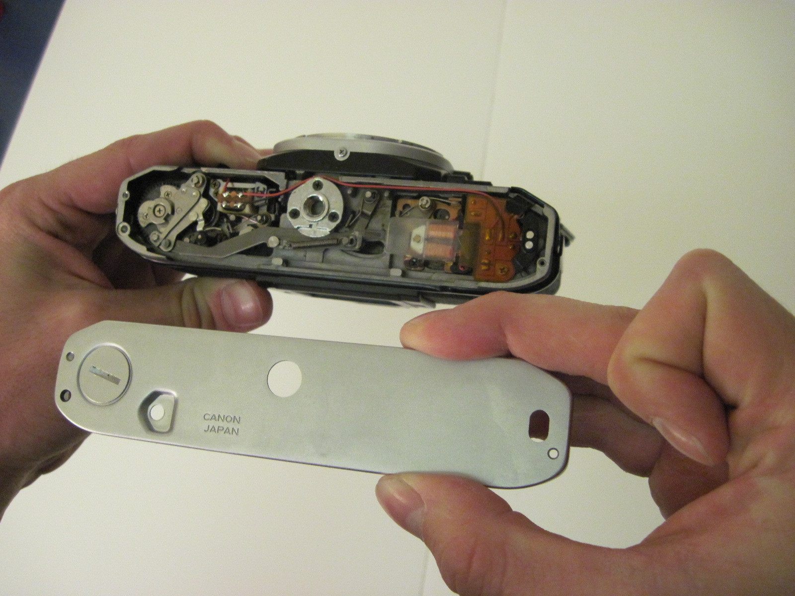

Why is the shutter magnet stuck?
After a trip to the sand dunes, I guess sand got into the camera because my camera started taking pictures as I pulled the film advance lever (and apparently this happens if dust or particles, like sand, interferes with the magnet.)
So... I decided to clean the magnet and fool around with the mechanics at the bottom of the camera. I eventually got the magnet to stick to the coils on its own.
BUT NOW... The problem is that the magnet can't detach from the coils on its own. I have to manually move the magnet if I want a picture taken. Does anyone know how to unstick the magnet without having to replace the magnet?

The magnet is an electromagnet so when current is applied it de-magnetizes for a split second to release the bar when then causes the shutter to function.
If the magnet is not releasing then the fire wires of the windings have become damaged as power is in unable to pass though it. Check to see if you damaged or dislodged something when you cleaned. If you don't see anything its time to break it into a camera repair person as you do need some specialized tools to test and repair the control circuitry as well as gain access to the needed parts.

hello great advise and what does the magnet look like after you take the cover off?

Here's an image with the bottom removed: Bottom cover removed. Do you see the two copper coils at the bottom under the plastic cover thats the release electromagnet.

I had the same problem, shutter firing as soon as I advanced the film.
I cleaned the magnet and coil ends that contact the magnet with isopropyl alcohol on a q tip
Then the magnet would stick but not release no matter what I done. I was stumped for a few days checking components and reading online but couldn't get an answer
Ultimately it was a very simple solution. Spray wd40 or light oil on a q tip and rub the areas that were cleaned with isopropyl alcohol. Worked immediately.
If it doesn't work for anybody reading this, check that the coil measures 90 ohms approx of resistance with a multimeter. If there's no resistance then you have an open coil which means find the break or replace the magnet/coil
It's a great little camera and I'm delighted to have mine working again
