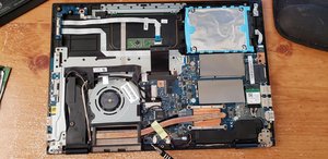

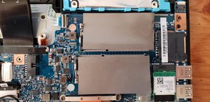

I am working on a toshiba satellite E45DW - C4210 laptop. This laptop has a bios password that needs to be reset. I am looking for the cmos reset jumpers on the motherboard I believe I have found them but I am looking for some sort of confirmation. Any insight is appreciated.

Did that work? I've been trying to remove a BIOS password too.
tarafından
It works. There is 4 sets of jumpers in that area, not in a line. If board is facing you in a manor you can read from left to right... It was the second down from top. Hope my crude jumper diagram below help. Look at first picture author posted. You will see the black plastic poking through the board, its not the one below it, but tomthe right of it...

Thr CMOS reset is JRST3201… just short those and start the laptop…
