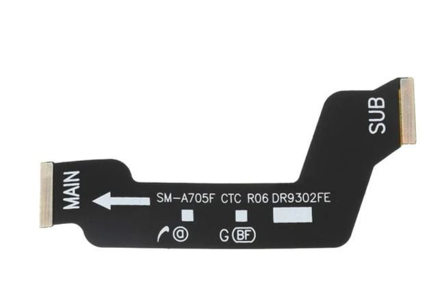

***Replacing Motherboard Connection Flex Cable worked for me solving this problemin more than 10 phones.

4 Yorum:
So I got my charging issue fixed by just pressing hard on the back of my phone and this seems to be the issue I guess.
tarafından
If i rplace the Motherboard Connection Flex Cable will it fix the problem of charging ?
tarafından
@Art avdiu possibly but it depends on what causes the issue. Start with the flex cable and see what happens.
tarafından
Great simple solution no need for a specialist
tarafından
