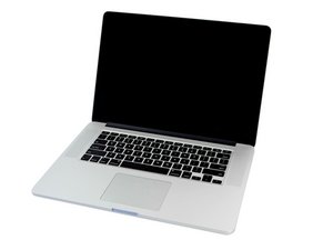

SSD from Bookyard keeps crashing
I have an old MacBook where I lost the original SSD when I used a third party one. I now ordered a (presumably refurbished) SSD from the Bookyard advertised as compatible for the same make but 500GB instead of 256. Upon installing it, the machine worked fine for about 5 minutes before shutting down without warning and also without any report upon rebooting successfully. This was repeated a few times, until I gave up. The shutdown happened sometimes less than a minute after booting, sometimes a few minutes later, maybe up to 5 or 6.
I assume that the Bookyard sent me a faulty SSD and I will contact them about it in the morning in the hope that they will replace it.
Is there something in general that I need to know about replacing SSDs for the MacBook? Is it a straightforward process or am I likely to have to say goodbye to my old machine? Does Mac replace hard disks for older models and what do they charge for it?

I would check your system using the build-in diagnostics. Restart your system and press the D key to enter.
You should also check your battery given your systems age, install this gem of an app! CoconutBattery take a snapshot of the apps main window and post it here for us to see Adding images to an existing question

There is very little which can go wrong physically.
  • Did you use proper ESD practices?
  • Did you over stress the connector, lifting the SSD to high so the logic board connector got damaged?
I wold focus on just getting a replacement SSD from TheBookYard they have always taken care of me.
