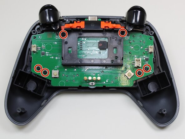

  7. GameSir Nova 2 Lite Button Replacement, Buttons: adım 7, 3 resimden 1. GameSir Nova 2 Lite Button Replacement, Buttons: adım 7, 3 resimden 2. GameSir Nova 2 Lite Button Replacement, Buttons: adım 7, 3 resimden 3.
    • Use a Phillips #0 screwdriver to remove the six 5.7 mm screws securing the motherboard.
    • Separate the midframe that holds the motherboard from the outer shell.
