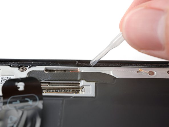

    18. Google Pixel 8 Screen Replacement, Remove the screen cable cover: adım 19, 3 resimden 1. Google Pixel 8 Screen Replacement, Remove the screen cable cover: adım 19, 3 resimden 2. Google Pixel 8 Screen Replacement, Remove the screen cable cover: adım 19, 3 resimden 3.
      • Use an opening pick to pry up the upper edge of the screen cable cover.
      • Remove the cover.

    19. Google Pixel 8 Screen Replacement, Disconnect the screen: adım 20, 3 resimden 1. Google Pixel 8 Screen Replacement, Disconnect the screen: adım 20, 3 resimden 2. Google Pixel 8 Screen Replacement, Disconnect the screen: adım 20, 3 resimden 3.
      • Insert the point of a spudger under the top left corner of the screen's press connector.
      • Gently pry up and disconnect the cable.
      • Remove the screen.
      • To reconnect a press connector, align it over its socket and gently press down on one side until it clicks into place, then press down on the other side. Don't press down in the middle. If the connector is misaligned, the pins can bend and cause permanent damage.
