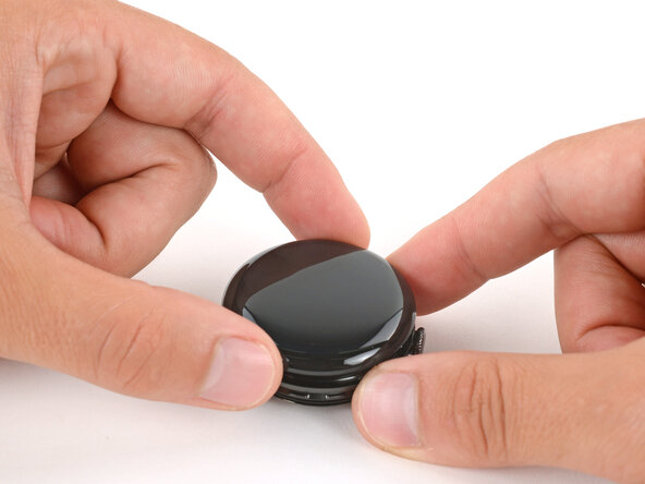

  3. Google Pixel Watch 4 Screen Replacement: adım 3, 1 resimden 1.
    • Throughout the rest of your repair, consider placing your watch on something soft like a clean cloth to help stabilize it and prevent scratches to the front glass.

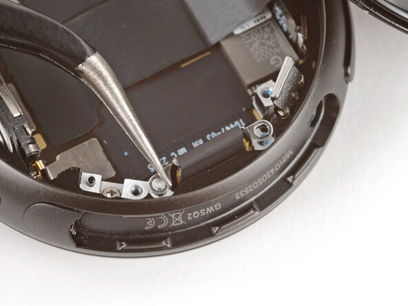

  4. Google Pixel Watch 4 Screen Replacement, Remove the back sensor glass screws: adım 4, 3 resimden 1. Google Pixel Watch 4 Screen Replacement, Remove the back sensor glass screws: adım 4, 3 resimden 2. Google Pixel Watch 4 Screen Replacement, Remove the back sensor glass screws: adım 4, 3 resimden 3.
    • Use a Torx Plus 2IP screwdriver to remove the 3.0 mm‑long screw from both watch band grooves (two screws total).
    • Both screws have a tiny O‑ring. If they don't lift away with the screw, use a pair of tweezers to carefully remove them from the band groove and set them aside. These O-rings are required to maintain waterproofing.
    • Handle these O-rings carefully. Avoid pinching or slicing them with your tool.

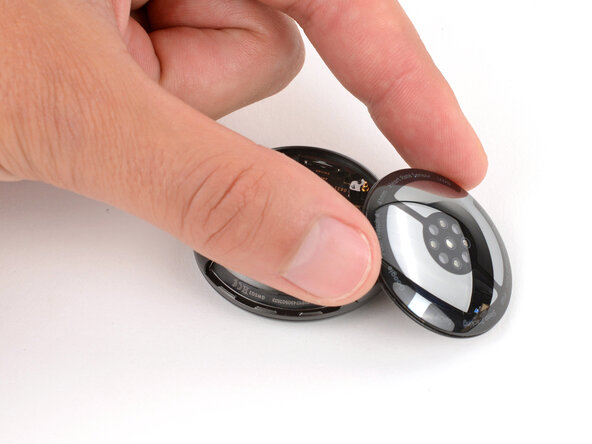

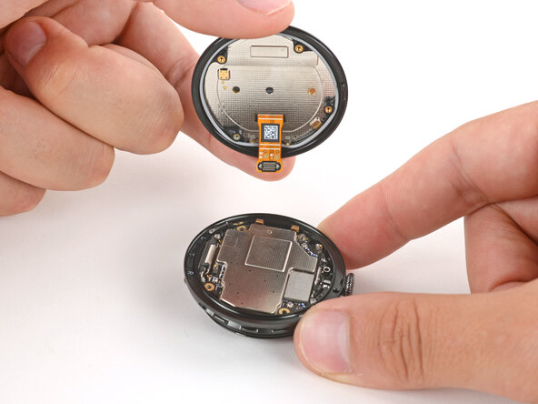

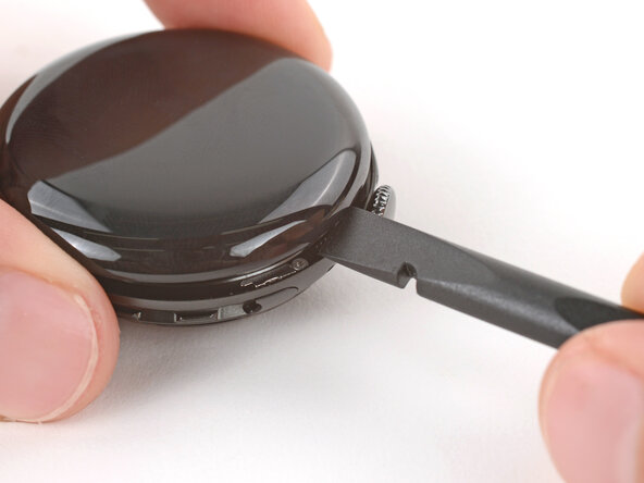

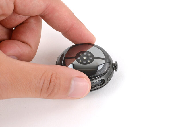

  5. Google Pixel Watch 4 Screen Replacement, Separate the back sensor glass: adım 5, 2 resimden 1. Google Pixel Watch 4 Screen Replacement, Separate the back sensor glass: adım 5, 2 resimden 2.
    • Insert the point of a spudger (or a clean fingernail) into the seam between the back sensor glass and frame and pry up until the cover detaches.

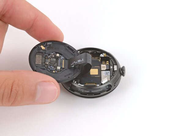

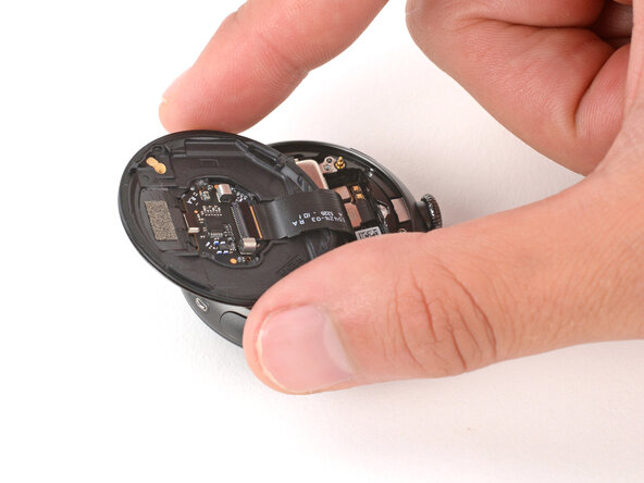

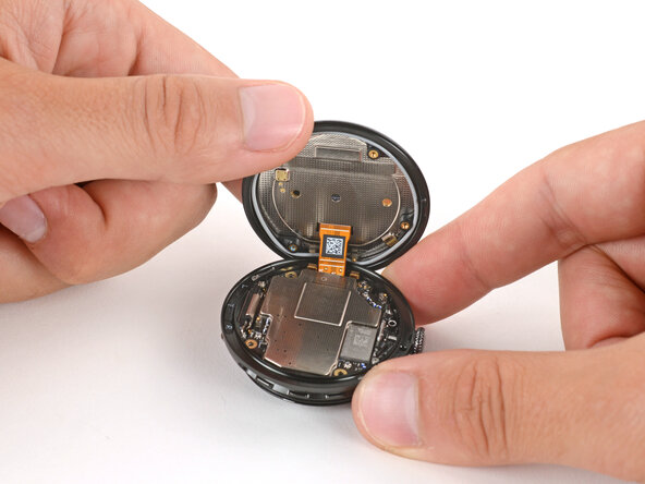

  6. Google Pixel Watch 4 Screen Replacement, Reposition the back sensor glass: adım 6, 3 resimden 1. Google Pixel Watch 4 Screen Replacement, Reposition the back sensor glass: adım 6, 3 resimden 2. Google Pixel Watch 4 Screen Replacement, Reposition the back sensor glass: adım 6, 3 resimden 3.
    • Gently lift the back glass and flip it over the side of the watch opposite the crown.
    • Be careful not to strain the cable connecting the back sensor glass.

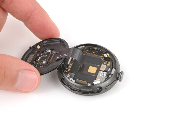

  9. Google Pixel Watch 4 Screen Replacement, Reposition the back sensor glass: adım 9, 3 resimden 1. Google Pixel Watch 4 Screen Replacement, Reposition the back sensor glass: adım 9, 3 resimden 2. Google Pixel Watch 4 Screen Replacement, Reposition the back sensor glass: adım 9, 3 resimden 3.
    • Gently flip the back sensor glass over the crown-side of the watch.

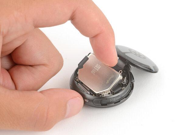

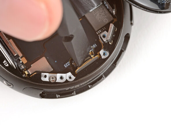

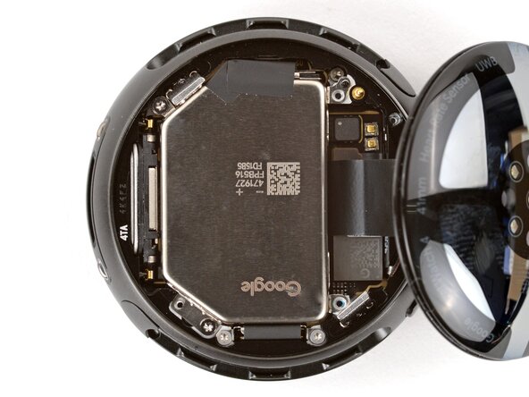

  10. Google Pixel Watch 4 Screen Replacement, Disconnect the battery: adım 10, 2 resimden 1. Google Pixel Watch 4 Screen Replacement, Disconnect the battery: adım 10, 2 resimden 2.
    • Use the point of a spudger to pry up and disconnect the battery press connector.
    • During reassembly, use the point of a spudger to press down and reconnect the press connector.
    • This can be tricky, and may take a few tries.
    • If you're having trouble, loosen the two battery screws and reposition the connector. Once connected, re-tighten the battery screws.

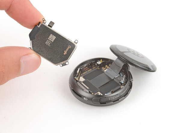

  11. Google Pixel Watch 4 Screen Replacement, Remove the battery screws: adım 11, 2 resimden 1. Google Pixel Watch 4 Screen Replacement, Remove the battery screws: adım 11, 2 resimden 2.
    • Use a Torx Plus 2IP screwdriver to remove the two 2.2 mm‑long screws securing the battery.
  12. Google Pixel Watch 4 Screen Replacement, Remove the battery: adım 12, 3 resimden 1. Google Pixel Watch 4 Screen Replacement, Remove the battery: adım 12, 3 resimden 2. Google Pixel Watch 4 Screen Replacement, Remove the battery: adım 12, 3 resimden 3.
    • Remove the battery.

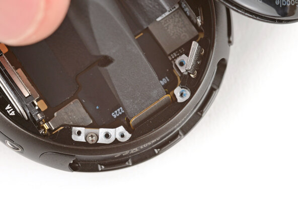

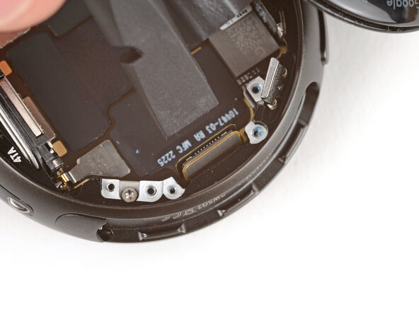

  13. Google Pixel Watch 4 Screen Replacement, Remove the screen cable bracket screws: adım 13, 2 resimden 1. Google Pixel Watch 4 Screen Replacement, Remove the screen cable bracket screws: adım 13, 2 resimden 2.
    • Use a Torx Plus 1IP screwdriver to remove the two 2.0 mm‑long screws seucuring the screen cable bracket.

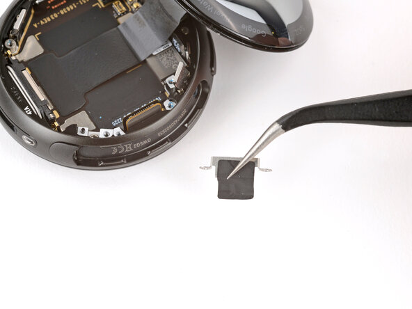

  14. Google Pixel Watch 4 Screen Replacement, Remove the screen cable bracket: adım 14, 3 resimden 1. Google Pixel Watch 4 Screen Replacement, Remove the screen cable bracket: adım 14, 3 resimden 2. Google Pixel Watch 4 Screen Replacement, Remove the screen cable bracket: adım 14, 3 resimden 3.
    • Use tweezers to flip the bracket up and slowly peel it off the connector, being careful not to damage the tape.
    • During reassembly, apply the tape to the outer press connector before flipping the bracket over and into place.

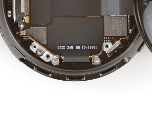

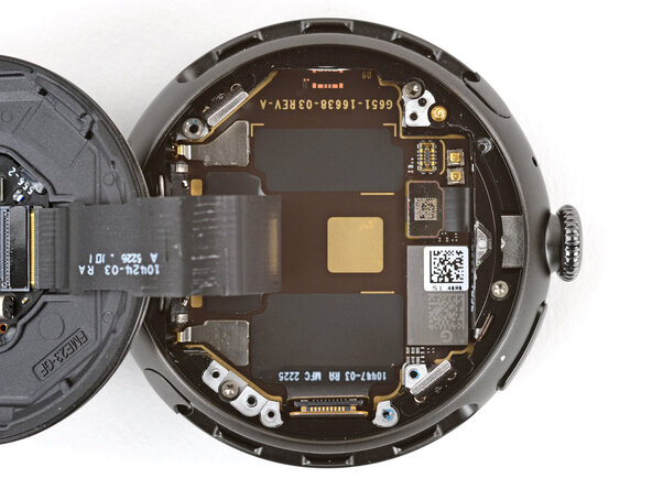

  15. Google Pixel Watch 4 Screen Replacement, Disconnect the screen cable: adım 15, 3 resimden 1. Google Pixel Watch 4 Screen Replacement, Disconnect the screen cable: adım 15, 3 resimden 2. Google Pixel Watch 4 Screen Replacement, Disconnect the screen cable: adım 15, 3 resimden 3.
    • Insert the flat end of a spudger into the gap in the two screen cable press connectors.
    • Twist the spudger to disconnect the cables.
    • During reassembly, line the press connectors up and pinch them together to connect them.

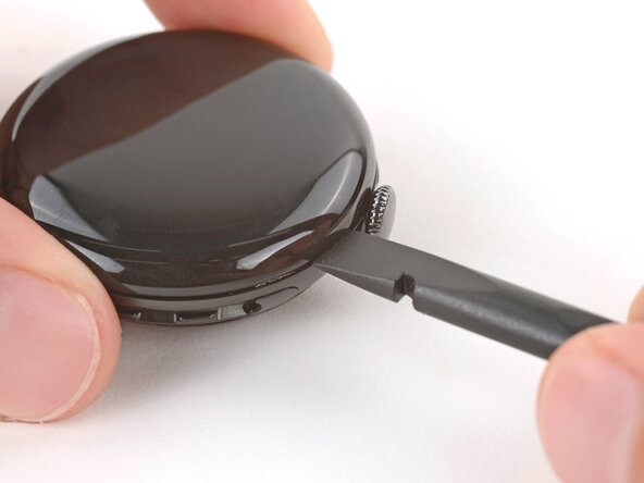

  19. Google Pixel Watch 4 Screen Replacement, Separate the screen: adım 19, 2 resimden 1. Google Pixel Watch 4 Screen Replacement, Separate the screen: adım 19, 2 resimden 2.
    • Insert the flat end of a spudger in the seam between the screen and frame and twist the spudger to separate the screen.
    • The display seals with an O-ring and might "pop" up once released.

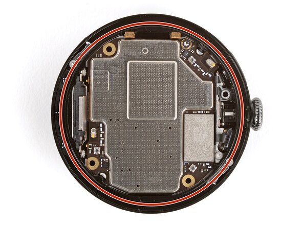

  21. Google Pixel Watch 4 Screen Replacement, O-ring installation: adım 21, 3 resimden 1. Google Pixel Watch 4 Screen Replacement, O-ring installation: adım 21, 3 resimden 2. Google Pixel Watch 4 Screen Replacement, O-ring installation: adım 21, 3 resimden 3.
    • If you plan to reuse the existing O-ring, be gentle when handling it—especially with sharp tweezers. Even a small indent may compromise the watch's water and dust resistance.
    • Use a pair of tweezers to remove the screen O‑ring—it will either be stuck to the frame or the underside of the screen.
    • If the O‑ring's groove is dirty or has gunk built up, apply a few drops of high‑concentration (>90%) isopropyl alcohol to a cotton swab and wipe it clean.
    • Avoid applying isopropyl alcohol to the magnetic strip on the side opposite the crown.
    • Place the new O‑ring loosely onto its lip on the frame.
    • Optionally, coat the O-ring in a small amount of O-ring-specific grease during installation.
    • Use your fingers to hold the O-ring in place and use a spudger to slide the opposite side up and over the lip until it seats in its groove.
    • Make sure the entire O‑ring is properly seated in its groove before continuing reassembly.
