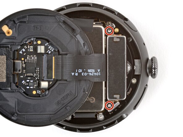

  7. Google Pixel Watch 4 Vibration Motor Replacement, Remove the vibration motor screws: adım 7, 2 resimden 1. Google Pixel Watch 4 Vibration Motor Replacement, Remove the vibration motor screws: adım 7, 2 resimden 2.
    • Optionally, you can disconnect the back glass to give you more room to work—though you can complete the repair just fine with it still connected.
    • Use a Torx Plus 2IP screwdriver to remove the two 2.2 mm‑long screws securing the vibration motor.
