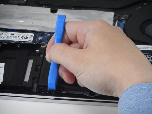

    2. HP ProBook 440 G6 Battery Replacement: adım 5, 1 resimden 1.
      • Use a tool to push the tab back on the bottom left of the battery.
