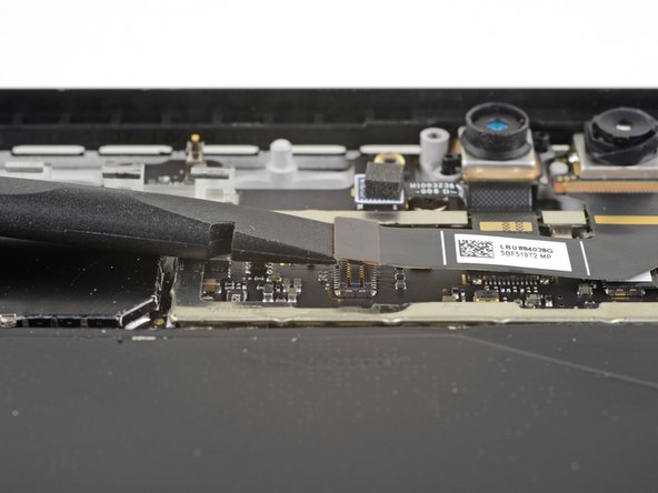

  32. Microsoft Surface Pro 6 Front-Facing Cameras Replacement, Disconnect the front-facing cameras: adım 32, 2 resimden 1. Microsoft Surface Pro 6 Front-Facing Cameras Replacement, Disconnect the front-facing cameras: adım 32, 2 resimden 2.
    • Use the flat end of a spudger to pry the front-facing camera connector up and out of its socket on the motherboard.
  33. Microsoft Surface Pro 6 Front-Facing Cameras Replacement: adım 33, 2 resimden 1. Microsoft Surface Pro 6 Front-Facing Cameras Replacement: adım 33, 2 resimden 2.
    • Use the flat end of a spudger to pry the face-detection camera connector up and out of its socket on the motherboard.

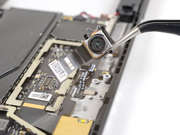

  34. Microsoft Surface Pro 6 Front-Facing Cameras Replacement, Remove the main front-facing camera: adım 34, 3 resimden 1. Microsoft Surface Pro 6 Front-Facing Cameras Replacement, Remove the main front-facing camera: adım 34, 3 resimden 2. Microsoft Surface Pro 6 Front-Facing Cameras Replacement, Remove the main front-facing camera: adım 34, 3 resimden 3.
    • Slide the flat end of a spudger under the main front-facing camera to lift it out of its recess in the case.
    • Remove the front-facing camera.

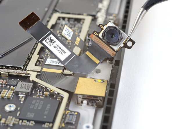

  35. Microsoft Surface Pro 6 Front-Facing Cameras Replacement, Remove the infrared face-detection camera: adım 35, 3 resimden 1. Microsoft Surface Pro 6 Front-Facing Cameras Replacement, Remove the infrared face-detection camera: adım 35, 3 resimden 2. Microsoft Surface Pro 6 Front-Facing Cameras Replacement, Remove the infrared face-detection camera: adım 35, 3 resimden 3.
    • Slide the flat end of a spudger under the infrared face-detection camera to lift it out of its recess in the case.
    • Remove the face-detection camera.
