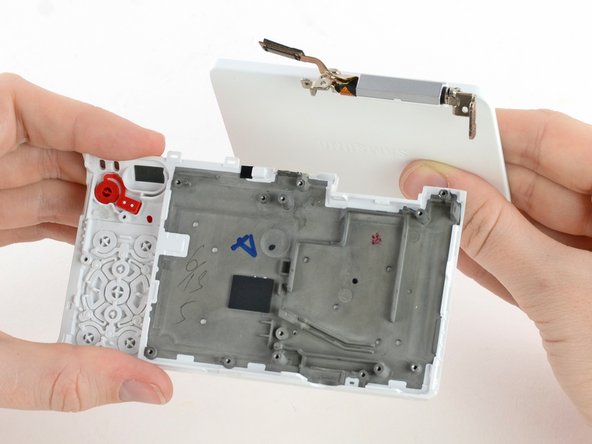

    • Use a Phillips #00 screwdriver to remove the three 4 mm screws from the bottom of the case.
  9. Samsung NX Mini LCD Replacement: adım 9, 2 resimden 1. Samsung NX Mini LCD Replacement: adım 9, 2 resimden 2.
    • Use your hands to slowly pull the front casing away from the camera.
    • The case is attached with multiple clips that may make a cracking noise as you pull it away from the camera.
