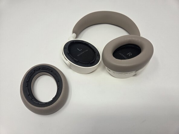

  1. Sennheiser Accentum Wireless Driver Assembly Replacement, Ear Pad: adım 1, 2 resimden 1. Sennheiser Accentum Wireless Driver Assembly Replacement, Ear Pad: adım 1, 2 resimden 2.
    • Gently pull up on the affected ear pad to remove it.

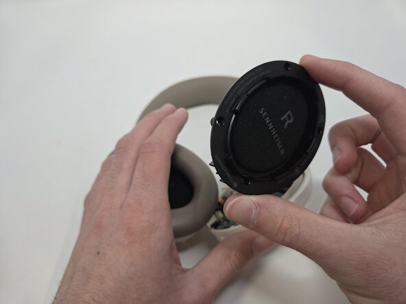

  2. Sennheiser Accentum Wireless Driver Assembly Replacement, Sennheiser Accentum Wireless Accessing Internal Hardware: adım 2, 2 resimden 1. Sennheiser Accentum Wireless Driver Assembly Replacement, Sennheiser Accentum Wireless Accessing Internal Hardware: adım 2, 2 resimden 2.
    • Remove the four black foam screw covers.

  3. Sennheiser Accentum Wireless Driver Assembly Replacement: adım 3, 2 resimden 1. Sennheiser Accentum Wireless Driver Assembly Replacement: adım 3, 2 resimden 2.
    • Use a Phillips #0 screwdriver to unscrew the screws on each earpiece. Each earpiece holds four, 6 mm screws.
    • The left earpiece holds the battery (the right earpiece holds the motherboard and buttons).

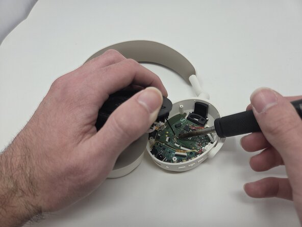

  4. Sennheiser Accentum Wireless Driver Assembly Replacement, Driver Assembly: adım 4, 2 resimden 1. Sennheiser Accentum Wireless Driver Assembly Replacement, Driver Assembly: adım 4, 2 resimden 2.
    • De-solder the wire connecting the driver assembly to the motherboard. If it's easier cut the wire and de-solder later then cut the wire. Click here for de-soldering tips.
    • Remove the driver assembly.

  5. Sennheiser Accentum Wireless Driver Assembly Replacement: adım 5, 1 resimden 1.
    • Solder the new driver assembly to its motherboard connection.
