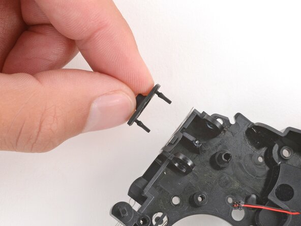

  23. Steam Controller (2nd Gen, 2026) Flexible Button Circuit Replacement, Remove the bumper membranes: adım 23, 3 resimden 1. Steam Controller (2nd Gen, 2026) Flexible Button Circuit Replacement, Remove the bumper membranes: adım 23, 3 resimden 2. Steam Controller (2nd Gen, 2026) Flexible Button Circuit Replacement, Remove the bumper membranes: adım 23, 3 resimden 3.
    • Use your fingers to gently pull both silicone bumper membranes off the controller.
    • During reassembly, press the membranes into place until both pegs slide fully into their sockets.

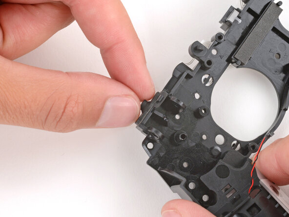

  24. Steam Controller (2nd Gen, 2026) Flexible Button Circuit Replacement, Unhook the bumper buttons: adım 24, 3 resimden 1. Steam Controller (2nd Gen, 2026) Flexible Button Circuit Replacement, Unhook the bumper buttons: adım 24, 3 resimden 2. Steam Controller (2nd Gen, 2026) Flexible Button Circuit Replacement, Unhook the bumper buttons: adım 24, 3 resimden 3.
    • Use tweezers or your fingers to gently unhook the section of button circuit for each bumper.

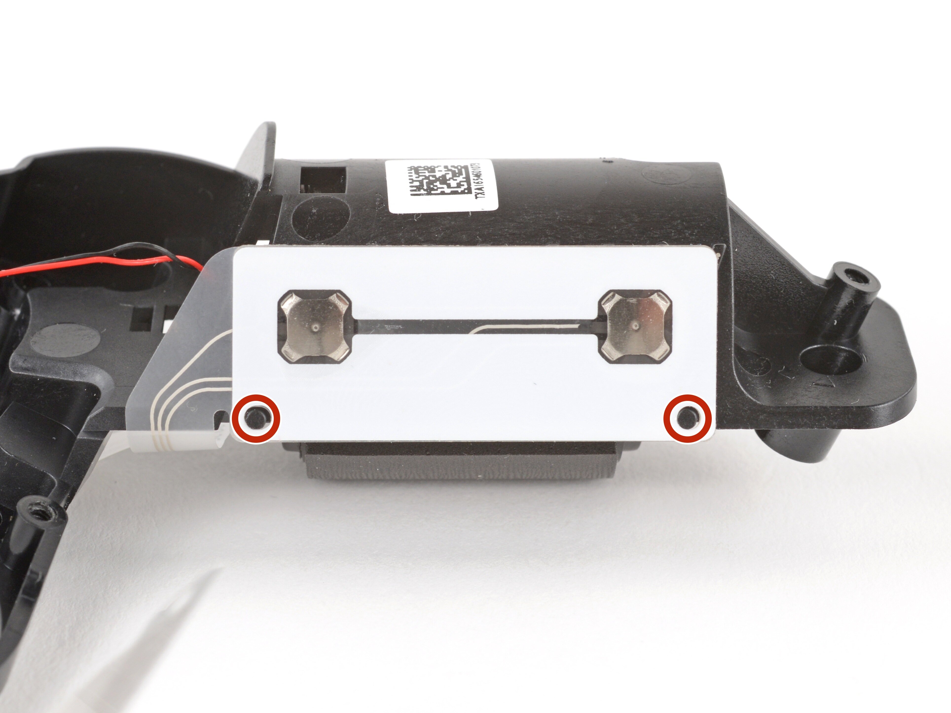

  28. Steam Controller (2nd Gen, 2026) Flexible Button Circuit Replacement, Remove the R4 and R5 buttons: adım 28, 3 resimden 1. Steam Controller (2nd Gen, 2026) Flexible Button Circuit Replacement, Remove the R4 and R5 buttons: adım 28, 3 resimden 2. Steam Controller (2nd Gen, 2026) Flexible Button Circuit Replacement, Remove the R4 and R5 buttons: adım 28, 3 resimden 3.
    • The two white, rectangular boards near the rumble motors are secured with mild ahdesive.
    • Slide the flat end of a spudger behind the board to separate the adhesive securing it.
    • Pull the board off the midframe.
  29. Steam Controller (2nd Gen, 2026) Flexible Button Circuit Replacement, Remove the L4 and L5 buttons: adım 29, 3 resimden 1. Steam Controller (2nd Gen, 2026) Flexible Button Circuit Replacement, Remove the L4 and L5 buttons: adım 29, 3 resimden 2. Steam Controller (2nd Gen, 2026) Flexible Button Circuit Replacement, Remove the L4 and L5 buttons: adım 29, 3 resimden 3.
    • Repeat to separate the other board.
    • During reassembly, check if your replacement button circuit has adhesive pre-installed on the boards. If it doesn't, use thin double-sided tape to secure them. Make sure the alignment pegs go through the holes in the bottom corners of the board.

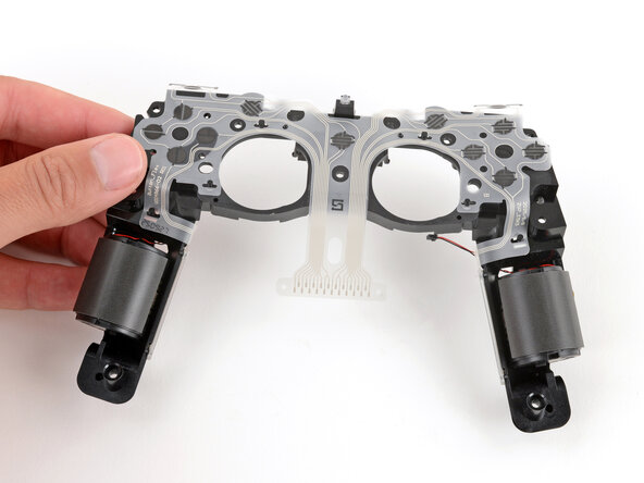

  30. Steam Controller (2nd Gen, 2026) Flexible Button Circuit Replacement, You're left with the button circuit: adım 30, 1 resimden 1.
    • Remove the midframe—you're now left with the button circuit for replacement.
