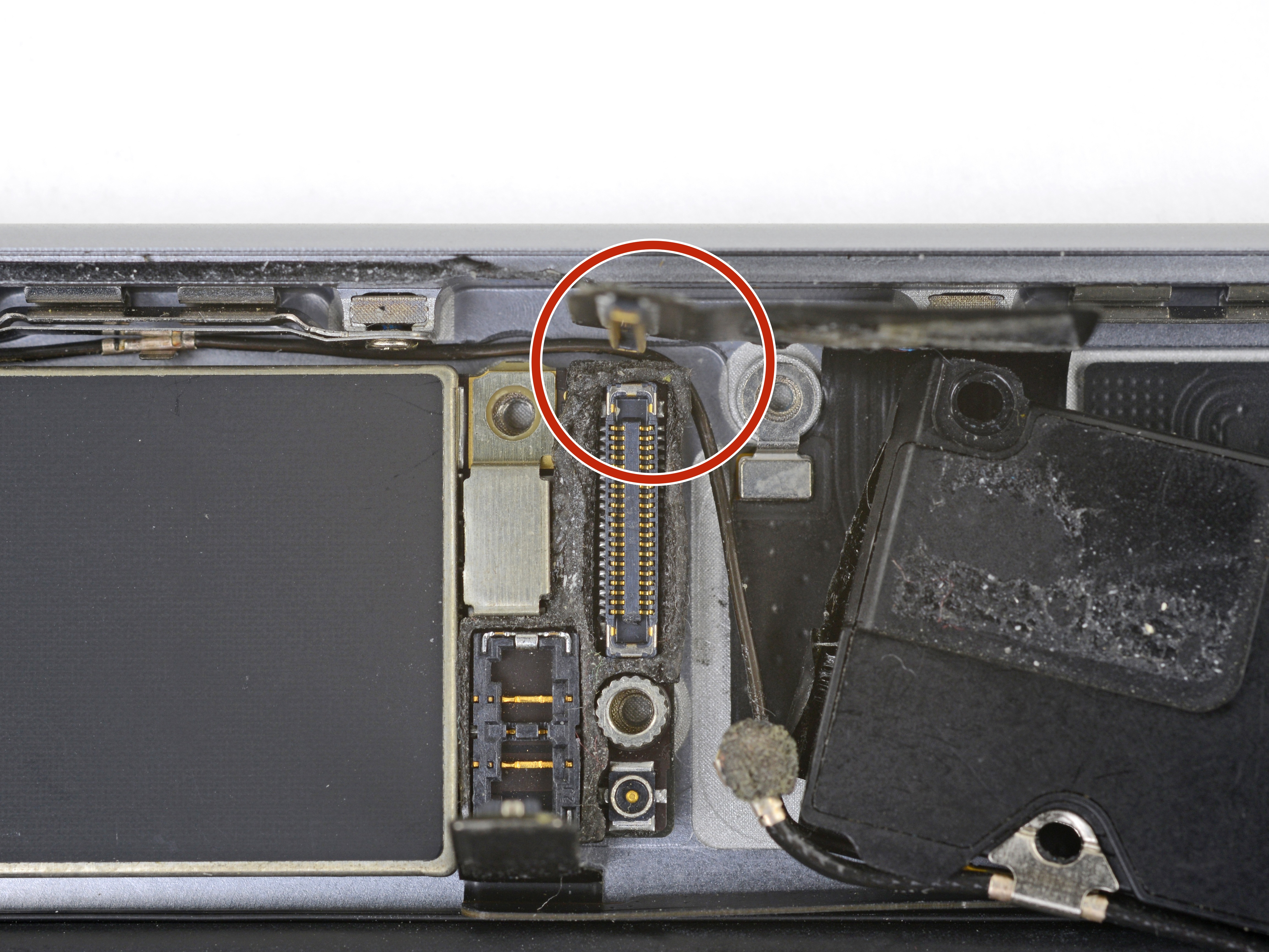

    • Use the point of a spudger to lift and disconnect the antenna cable from the bottom end of the logic board.
    • To reconnect antenna cables like these to the socket, carefully align the connector to the socket, then use the flat end of a spudger to press down. It should click in place. If not, check for alignment. Do not use excessive force.

    • Use the point of a spudger to lift up and disconnect the Lightning connector ribbon cable from its socket on the logic board.

  32. iPhone 6s Lightning Connector Assembly Replacement: adım 32, 3 resimden 1. iPhone 6s Lightning Connector Assembly Replacement: adım 32, 3 resimden 2. iPhone 6s Lightning Connector Assembly Replacement: adım 32, 3 resimden 3.
    • Insert the flat end of a spudger between the long edge of the speaker module and the case wall.
    • Pry gently to loosen the speaker module.
    • Once the module is loose, lift and remove the speaker module from the phone.
