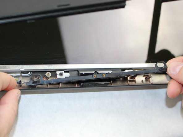

  • Push in the assembly towards the spring.
  • Gently lift the slider from the side opposite to the spring and pull the slider away from the spring.
  • The spring is loosely secured to the slider and may fall off and become lost when removing the slider.
