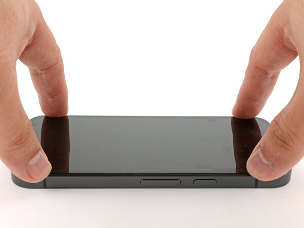

  1. Google Pixel 10a Screen Replacement, Prepare your Pixel for disassembly: adım 1, 2 resimden 1. Google Pixel 10a Screen Replacement, Prepare your Pixel for disassembly: adım 1, 2 resimden 2.
    • Let your Pixel's battery drain below 25% before starting this repair. A charged lithium‑ion battery may catch fire if damaged.
    • Unplug all cables and completely power down your Pixel.
    • If your rear cover is bulging, your battery may be swollen—take appropriate precautions.

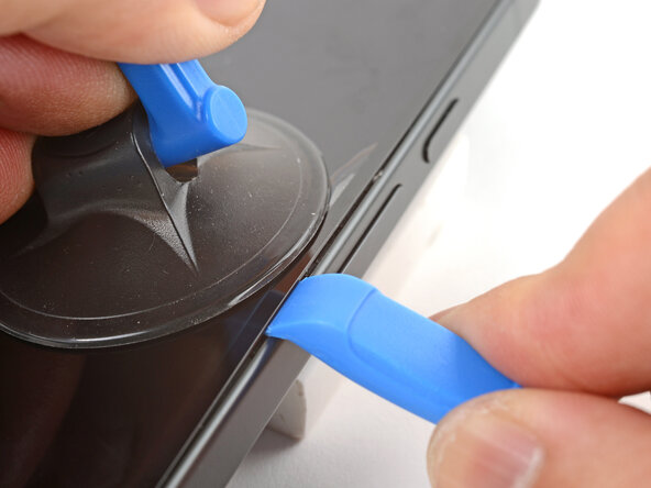

  5. Google Pixel 10a Screen Replacement, Create a gap with the opening tool: adım 5, 3 resimden 1. Google Pixel 10a Screen Replacement, Create a gap with the opening tool: adım 5, 3 resimden 2. Google Pixel 10a Screen Replacement, Create a gap with the opening tool: adım 5, 3 resimden 3.
    • Apply a suction handle to the center of the screen's right edge.
    • Pull up on the suction handle with strong, steady force to create a gap.
    • The adhesive is very strong. If you're having trouble, reheat the edge and pull again. Repeated heating and pulling cycles will weaken the adhesive.
    • Press the edge of the opening tool (curved downwards) into the gap.

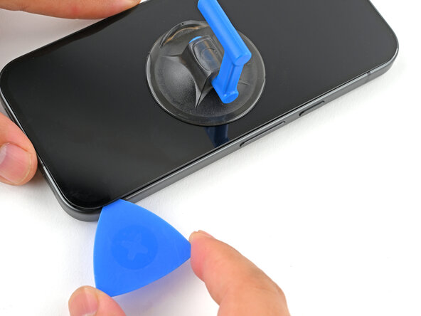

  7. Google Pixel 10a Screen Replacement, Create a gap with a metal pick: adım 7, 2 resimden 1. Google Pixel 10a Screen Replacement, Create a gap with a metal pick: adım 7, 2 resimden 2.
    • The next two steps show how to create a gap with a metal pick as an alternate method.
    • Insert the tip of the metal opening pick into the gap.

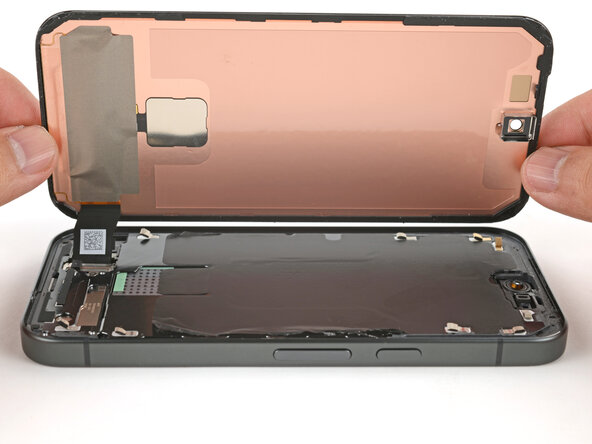

  12. Google Pixel 10a Screen Replacement: adım 12, 1 resimden 1.
    • Swing the screen over the left edge of your phone (like opening the cover of a book) and lay it down flat.
    • If you feel resistance when lifting the screen, use an opening pick to separate any leftover adhesive.
