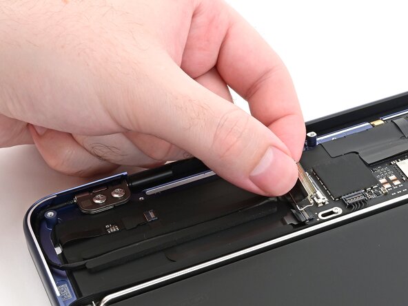

    1. MacBook Neo Screen Replacement, Disconnect the display cable: adım 13, 2 resimden 1. MacBook Neo Screen Replacement, Disconnect the display cable: adım 13, 2 resimden 2.
      • Use the flat end of a spudger to gently push under the metal buckle of the display cable connector, located on the top‑right corner of the logic board, to unclip it.
      FixBot'a Sor
      Yorum Ekle
    2. MacBook Neo Screen Replacement: adım 14, 2 resimden 1. MacBook Neo Screen Replacement: adım 14, 2 resimden 2.
      • Grab the buckle and cable together and gently pull the connector straight out of its socket.
      FixBot'a Sor
