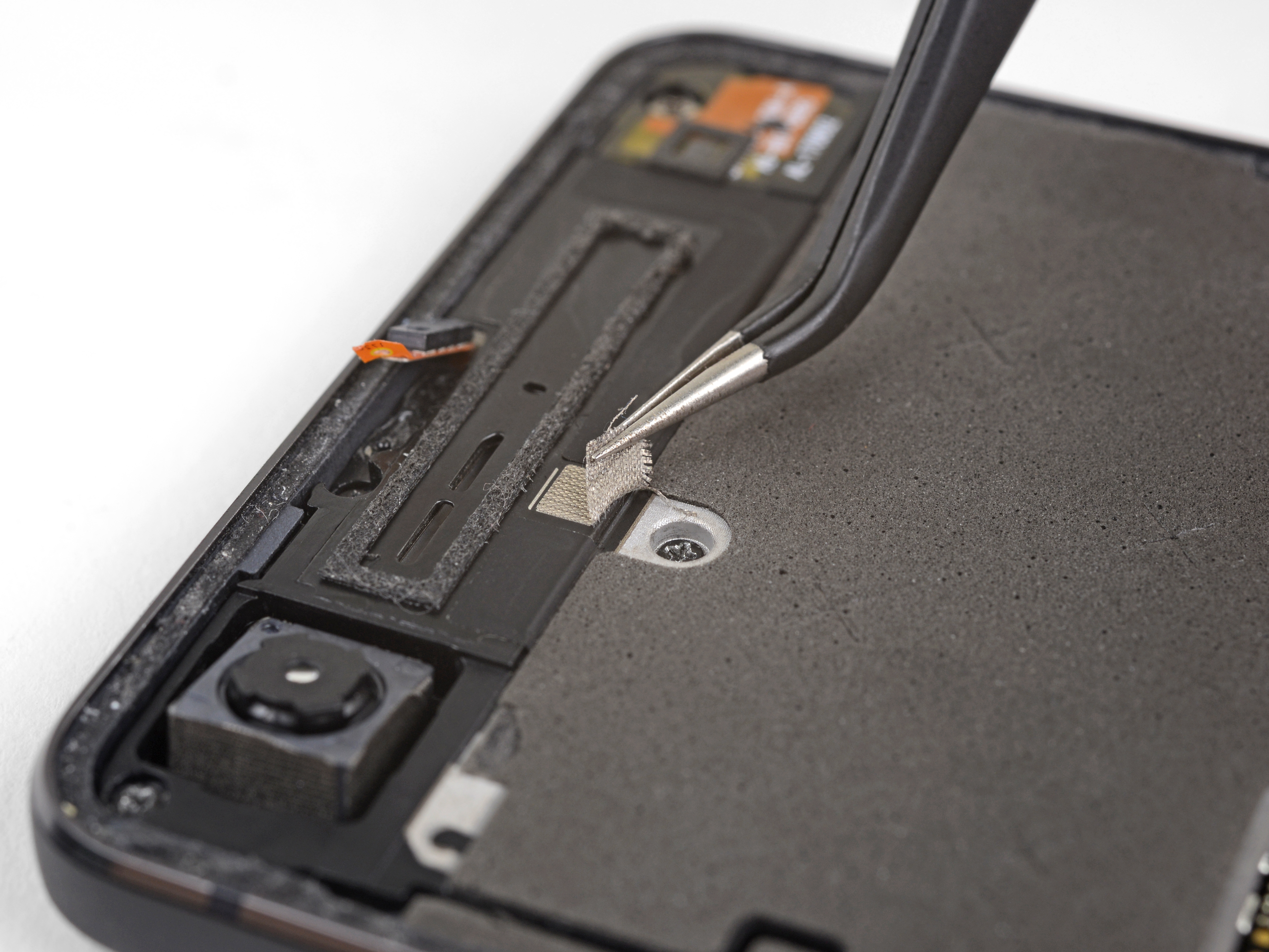

    1. Google Pixel 2 Battery Replacement, Midframe: adım 12, 1 resimden 1.
      • Apply a heated iOpener to the proximity sensor on the top edge of the midframe for two minutes to soften its adhesive.

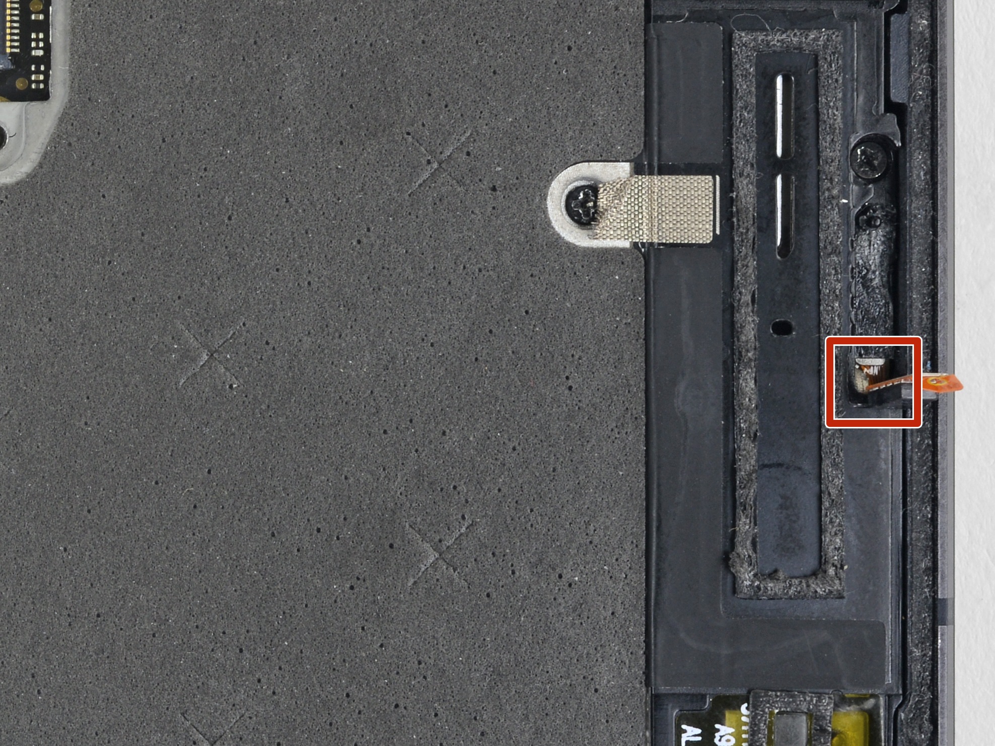

    2. Google Pixel 2 Battery Replacement: adım 13, 2 resimden 1. Google Pixel 2 Battery Replacement: adım 13, 2 resimden 2.
      • Slide the point of a spudger under the proximity sensor cable, starting from the side closest to the front-facing camera.
      • Gently lift the edge of the sensor cable until the sensor is perpendicular to the midframe.
