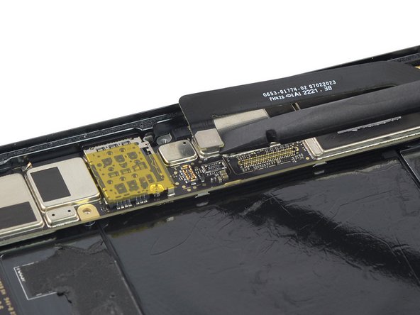

  17. Google Pixel 7 Motherboard Replacement, Disconnect the display cable: adım 17, 2 resimden 1. Google Pixel 7 Motherboard Replacement, Disconnect the display cable: adım 17, 2 resimden 2.
    • Use a spudger to disconnect the display flex cable by prying the connector straight up from its socket.
    • To re-attach press connectors like this one, carefully align and press down on one side until it clicks into place, then repeat on the other side. Do not press down on the middle. If the connector is misaligned, the pins can bend, causing permanent damage.

  35. Google Pixel 7 Motherboard Replacement, Disconnect the mmWave antenna cable: adım 35, 2 resimden 1. Google Pixel 7 Motherboard Replacement, Disconnect the mmWave antenna cable: adım 35, 2 resimden 2.
    • Use a spudger to disconnect the mmWave antenna cable by prying the connector straight up from its socket.
