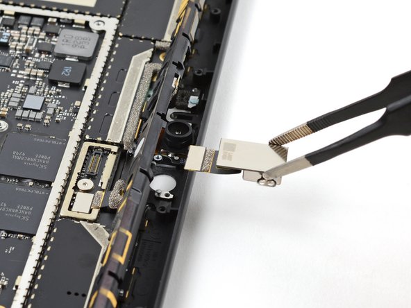

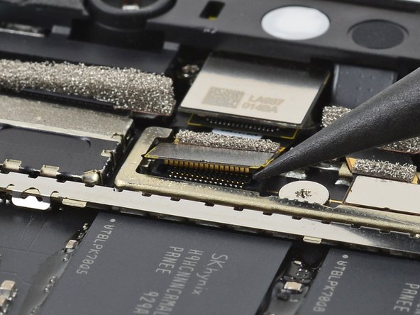

  35. Microsoft Surface Pro X Rear Camera Replacement, Remove the rear camera shield: adım 35, 2 resimden 1. Microsoft Surface Pro X Rear Camera Replacement, Remove the rear camera shield: adım 35, 2 resimden 2.
    Bu adımda kullanılan alet:
    • Insert one tine of a pair of pointed tweezers under one corner of the shield covering the rear camera connector.
    • Lift up the corner to detach it from the frame.
    • If you are going to reuse this shield, try to avoid excessively bending it during removal.
  36. Microsoft Surface Pro X Rear Camera Replacement: adım 36, 3 resimden 1. Microsoft Surface Pro X Rear Camera Replacement: adım 36, 3 resimden 2. Microsoft Surface Pro X Rear Camera Replacement: adım 36, 3 resimden 3.
    • Repeat the previous step for the remaining three corners of the shield.
  37. Microsoft Surface Pro X Rear Camera Replacement: adım 37, 2 resimden 1. Microsoft Surface Pro X Rear Camera Replacement: adım 37, 2 resimden 2.
    • Use a pair of pointed tweezers to lift up the left side of the shield.
  38. Microsoft Surface Pro X Rear Camera Replacement: adım 38, 2 resimden 1. Microsoft Surface Pro X Rear Camera Replacement: adım 38, 2 resimden 2.
    • Slide one tine of a pair of pointed tweezers under the bottom right edge of the shield to fully detach it from the frame.
  39. Microsoft Surface Pro X Rear Camera Replacement: adım 39, 1 resimden 1.
    • Remove the shield covering the rear camera connector.
    • If the shield isn't completely detached from the frame, pry up additional areas on the edges of the shield.
  40. Microsoft Surface Pro X Rear Camera Replacement, Disconnect the rear camera: adım 40, 2 resimden 1. Microsoft Surface Pro X Rear Camera Replacement, Disconnect the rear camera: adım 40, 2 resimden 2.
    • Use the pointed end of a spudger to pry up the rear camera press connector and disconnect it from its socket.
