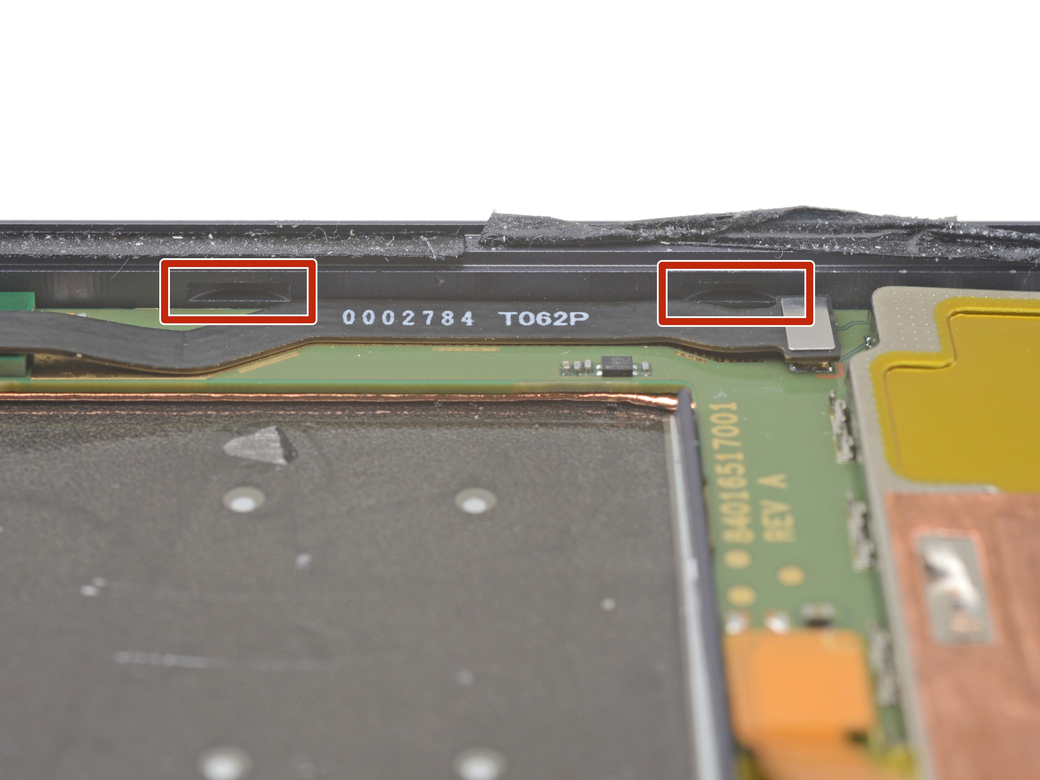

    12. Moto Z Battery Replacement: adım 12, 3 resimden 1. Moto Z Battery Replacement: adım 12, 3 resimden 2. Moto Z Battery Replacement: adım 12, 3 resimden 3.
      • Lift the earpiece end of the display up to provide access to the display cables.
      • Do not open the display beyond 90 degrees, and always support the display panel.
