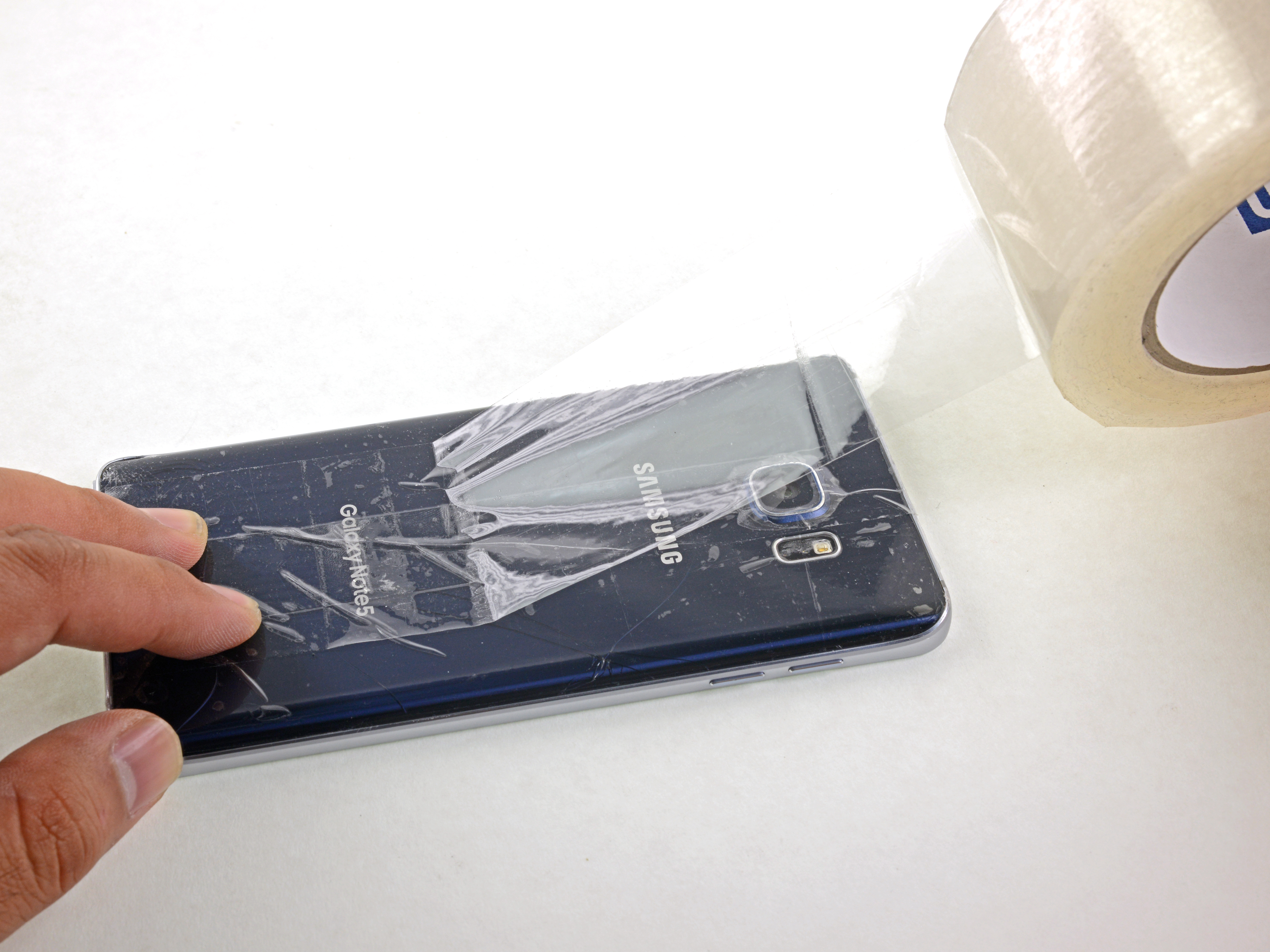

  3. Samsung Galaxy Note5 Battery Replacement, Rear Glass: adım 3, 1 resimden 1.
    • If the glass back is cracked, carefully tape over the entire surface with packing tape.
    • Apply a heated iOpener to the bottom of the phone for about two minutes.
    • You may need to reheat and reapply the iOpener several times to get the phone warm enough. Follow the iOpener instructions to avoid overheating.
    • A hair dryer, heat gun, or hot plate may also be used, but be careful not to overheat the phone—the OLED display and internal battery are both susceptible to heat damage.
