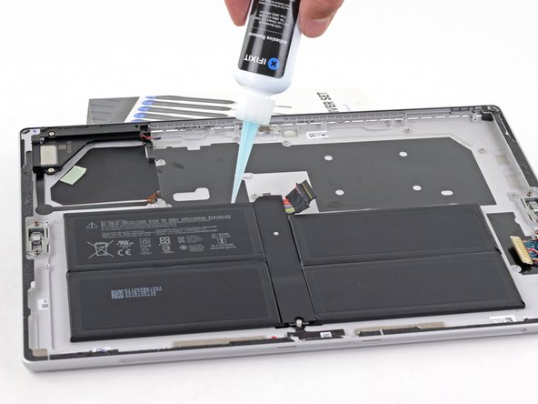

  7. Microsoft Surface Pro 7 Battery Replacement: adım 7, 1 resimden 1.
    • Reheat your iOpener and apply it to the bottom edge of the Surface's screen for two minutes.
    • You may need to reheat and reapply the iOpener several times to get the tablet warm enough. Follow the iOpener instructions to avoid overheating.
    • A hair dryer or heat gun may also be used for more heat, but be careful not to overheat the Surface—the screen and internal battery are susceptible to heat damage.

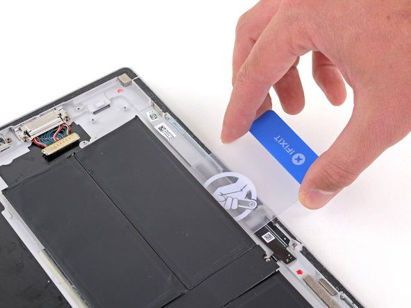

  8. Microsoft Surface Pro 7 Battery Replacement: adım 8, 3 resimden 1. Microsoft Surface Pro 7 Battery Replacement: adım 8, 3 resimden 2. Microsoft Surface Pro 7 Battery Replacement: adım 8, 3 resimden 3.
    • Insert a new opening pick into the bottom right corner and slide it around the corner toward the bottom edge.
    • Don't insert the opening pick any deeper than the black bezel on the side of the screen. Inserting the pick too far may damage the LCD.
    • Slide the pick along the bottom edge of the Surface to cut through the screen adhesive.
    • Leave this pick in the bottom edge to prevent the adhesive from resealing.
  9. Microsoft Surface Pro 7 Battery Replacement: adım 9, 1 resimden 1.
    • Reheat your iOpener and apply it to the left edge of the Surface's screen for two minutes.
  10. Microsoft Surface Pro 7 Battery Replacement: adım 10, 3 resimden 1. Microsoft Surface Pro 7 Battery Replacement: adım 10, 3 resimden 2. Microsoft Surface Pro 7 Battery Replacement: adım 10, 3 resimden 3.
    • Insert a new opening pick into the bottom left corner and slide it around the corner toward the left edge.
    • Be careful cutting under the lower 2.5 inches (65 mm) of the left edge. Do not insert the opening pick more than 1/8 inch (3 mm) here. The display cables sit near this part of the bezel and are easily damaged. Once past the display cable area, do not insert the pick past the bezel.
    • Slide the pick along the left edge of the Surface to cut through the screen adhesive.
    • Leave this pick in the left edge to prevent the adhesive from resealing.

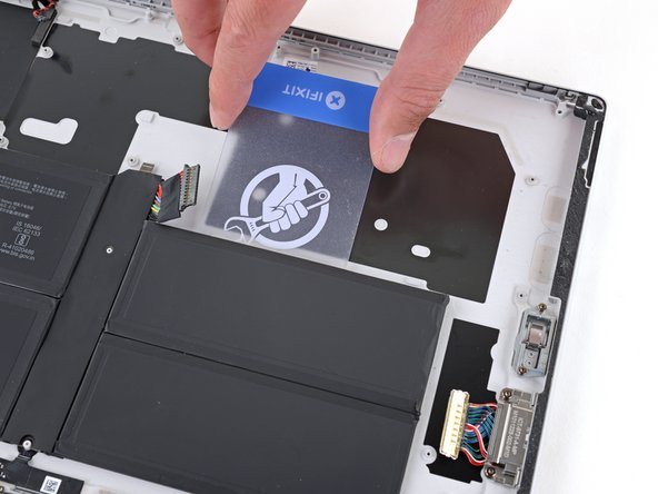

  13. Microsoft Surface Pro 7 Battery Replacement: adım 13, 3 resimden 1. Microsoft Surface Pro 7 Battery Replacement: adım 13, 3 resimden 2. Microsoft Surface Pro 7 Battery Replacement: adım 13, 3 resimden 3.
    • Fragile antenna cables lie under the top edge of the screen. Carefully follow the procedure to avoid damaging them.
    • Insert the point of a pick under the display where you just stopped cutting. Do not insert the pick deeper than the edge of the bezel.
    • Carefully roll the pick to the right, pressing the long edge of the pick into the screen adhesive underneath the bezel, cutting the adhesive as you go. Do not slide the pick along the edge of the Surface.
    • Repeat this motion of inserting the point of the pick where you just cut, and rolling to the right all along the top edge of the Surface, until the pick is 2.5 inches (64 mm) from the right edge of the Surface.

  50. Microsoft Surface Pro 7 Battery Replacement, Remove the battery: adım 50, 3 resimden 1. Microsoft Surface Pro 7 Battery Replacement, Remove the battery: adım 50, 3 resimden 2. Microsoft Surface Pro 7 Battery Replacement, Remove the battery: adım 50, 3 resimden 3.
    • Prop the top edge of the Surface up a couple inches so the whole Surface slopes toward the bottom edge.
    • Apply adhesive remover or high-concentration (90% or higher) isopropyl alcohol underneath the the battery along the top edge.
    • If you are using adhesive remover, follow these preparation steps first.
    • Let the adhesive remover sit and soak into the adhesive for 2–3 minutes before continuing.
  51. Microsoft Surface Pro 7 Battery Replacement: adım 51, 3 resimden 1. Microsoft Surface Pro 7 Battery Replacement: adım 51, 3 resimden 2. Microsoft Surface Pro 7 Battery Replacement: adım 51, 3 resimden 3.
    Bu adımda kullanılan alet:
    Plastic Cards
    $2.99
    • Take care not to puncture or bend the battery with your tools—a punctured or bent battery may leak dangerous chemicals or cause a thermal event.
    • Slide a plastic card under the right side of the top edge of the battery.
    • If you encounter significant resistance at any point during this procedure, stop, apply a little more adhesive remover, and wait for it to soak in.
    • Slide the card side to side under the upper right battery cell to slice through the adhesive underneath.
  52. Microsoft Surface Pro 7 Battery Replacement: adım 52, 3 resimden 1. Microsoft Surface Pro 7 Battery Replacement: adım 52, 3 resimden 2. Microsoft Surface Pro 7 Battery Replacement: adım 52, 3 resimden 3.
    • Slide a plastic card under the right side of the bottom edge of the battery.
    • Slide the card side to side under the bottom right battery cell to slice through the adhesive underneath.
    • Repeat the previous two steps for the left side of the battery to release the two left cells from their adhesive.
  53. Microsoft Surface Pro 7 Battery Replacement: adım 53, 3 resimden 1. Microsoft Surface Pro 7 Battery Replacement: adım 53, 3 resimden 2. Microsoft Surface Pro 7 Battery Replacement: adım 53, 3 resimden 3.
    • Lift each side of the battery with a plastic card and make sure all the adhesive is separated from the battery.
    • Gently lift the battery out of the case.
    • Do not reuse the battery after it has been removed, as doing so is a potential safety hazard. Replace it with a new battery.
    • During reassembly, follow this guide to clean off old adhesive and apply new adhesive from a pre-cut adhesive card.
